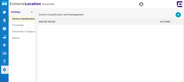

  1. Select Settings > System Settings > Device Classification.
    The Device Classification and Management window opens. This window displays the device classification rules configured for this ExtremeLocation Essentials account.
  2. Select the icon. The following menu displays.
  3. Select the Add Device Rule menu item to add a new Device Classification and Management rule.

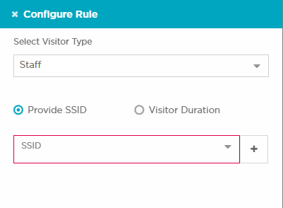

    The Configure Rule screen displays.
  4. Configure the following to create a device classification rule:
    Select Visitor type
    Use the drop-down list to select the appropriate visitor type. The following options are available:
    • Asset
    • Staff
    • Staff Personal Devices
    You can create one rule per visitor type. Once a rule for a visitor type is created, it is no longer available as a selection in this drop-down list.
    Provide SSID
    Devices are classified based on the SSID that the device associates itself to at the site.
    Visitor Duration
    Devices are classified based on the duration the device remains at the site.
  5. Select Provide SSID to classify devices based on the SSID that the device associates itself to at the site.
    When classifying devices using SSIDs, you must manually provide the SSID that is used for the classification. Use the button to add SSIDs manually. The following field appears when you select the button.
    Enter a valid SSID into the SSID field and select Add to add the entered SSID to the list. Then, select the appropriate SSID from the SSID drop-down list to create your classification rule.

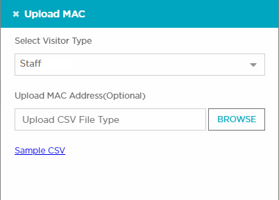

  8. Select the icon. The following menu displays.
  9. Select Upload MAC Address menu item to add a list of device MAC addresses.
    The Upload MAC screen displays.
  10. Use the Select Visitor Type drop-down list to select the visitor type for the devices in this list.
  11. Use the Browse button to search for and upload a Comma Separated Value file to the ExtremeLocation Essentials account.
    Use the Sample CSV link to download a sample file to base your manual device classification data CSV file.
  12. Select Save to save the changes made to the Device Classification parameters.
