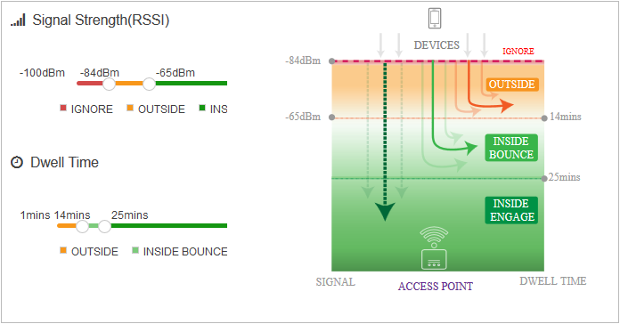

Set the following Presence values:
Signal Strength (RSSI) slider
Use the Signal Strength slider to set the values for device classification as one of Ignored Devices, Outside Devices, and Inside Devices.
A device is ignored if the signal strength (RSSI) of the device is below the signal strength value set by the first slider knob. This is indicated by the red portion of the Signal Strength (RSSI) slider. These devices will not be tracked for analysis.
A device is considered as Inside if the signal strength (RSSI) of the device is above the signal strength value set by the second slider knob. This is indicated by the green portion of the Signal Strength (RSSI) slider.
A device with a signal strength reading between the two knobs of the Signal Strength (RSSI) slider is considered as Outside. This is indicated by the orange portion of the Signal Strength (RSSI) slider.

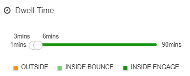

Dwell Time slider
Use the Dwell Time slider to set the values for device classification as one of Outside, Inside Bounce, or Inside Engaged.
A device is classified as Outside if the device is seen in the site for a duration that is less the duration set by the first slider knob. This threshold is indicated by the orange portion of the Dwell Time slider.
A device is classified as Inside Engaged if the device is seen in the site for a duration greater than the duration set by the second slider knob. This threshold is indicated by the dark green portion of the Dwell Time slider.
A device that is seen at the site for a duration between the times indicated by the two knobs of the Dwell Time slider is considered as Inside Bounced. This duration is indicated by the light green portion of the Dwell Time slider.
Presence Configuration Graph
Use the graph located to the right of the Signal Strength (RSSI) and Dwell Time sliders to get a visual representation of the values used for device classification.
