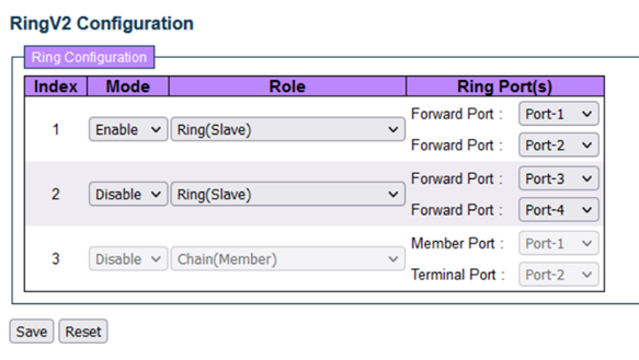

Configuring the Ring Slave
Navigate to
Configuration
RingV2
Enable Index1, and select role as
Ring(Slave)
Select two ports as Forward Ports.
