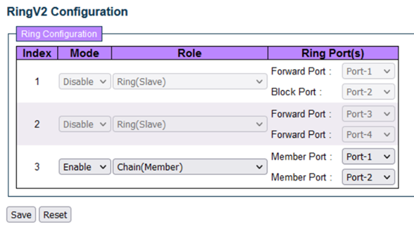

Configuring Chain Member
Navigate to
Configuration
RingV2
Disable Index1 and Index2, and then enable Index3.
Select role as
Chain(Member)
Select two member ports for this chain member switch.
