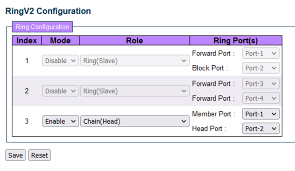

Configuring Chain Head
Navigate to
Configuration
RingV2
Disable Index1 and Index2, and then enable Index3.
Select role as
Chain(Head)
Select a member port and a head port for this chain head switch.
