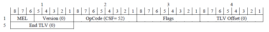

The ETH-CSF protocol data unit (PDU) structure is detailed below.
The format of the CSF PDU used to support the ETH-CSF function is shown in the following figure.
The fields of the CSF PDU format are described in the following table.
| Field | Description |
| MEG Level | 3-bit field to carry the local MEG level |
| Version | 0 |
| OpCode | PDU type is CSF (52) |
| Flags | 3-bit Type sub-element and a 3-bit Period sub-element |
The format of the Flags field is illustrated in the following figure.
