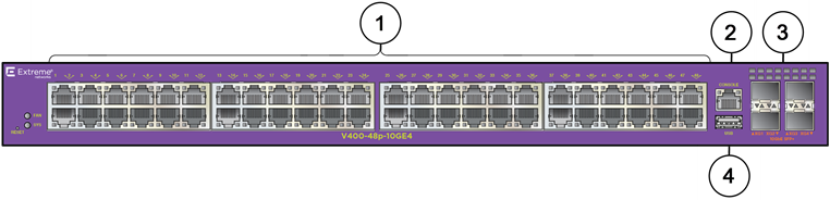

All models include either two or four SFP+ ports on the faceplate of each base unit, which can be provisioned either as uplink or cascade ports. This gives administrators the option to create redundant links or downstream cascade ports to other V400 units. The SFP+ ports are the only ones that can be used as uplink ports in a cascading configuration.

V400 Virtual Port Extender Front Panel (48-port Model Shown)

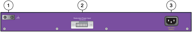

V400 Virtual Port Extender Rear Panel
