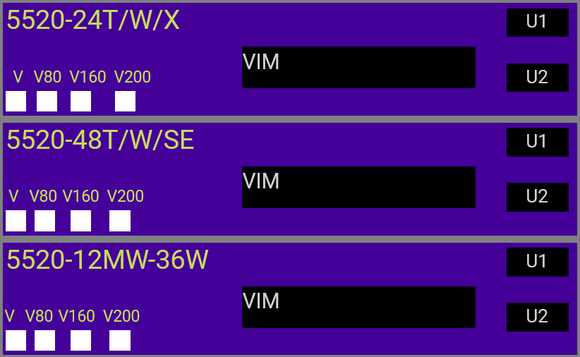

To use the Stacking Tool, follow these steps.
The Stacking Tool is also available in the Support Tools section of the Extreme Portal.Each switch model is represented by a rectangle, as shown in the example in the following figure.ach switch model is represented by a rectangle, as shown in the example in the following figure. In this example, stacking ports are represented by U1 and U2 on the right side.
Tip
Select a rectangle to display more information about the switch model and the VIMs (if any) that it can use for stacking.To the right of the Stack column, the tool displays statistics about available routes, supported software versions, and primary/backup recommendations.
Tip
If you do not see statistics and other information, select the arrow (> symbol) to the immediate right of the Stack column.Whenever you add or remove a switch from the stack, the statistics and recommendations update automatically.
In addition to statistics and recommendations, colors in the display show whether the selected switches and stacking modes are compatible.
