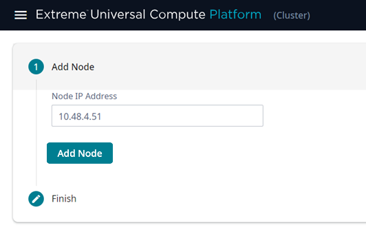

To add a node to a cluster, take the following steps:
  1. Go to Cluster Settings > Add Node.
    Add Node dialog
  2. Provide the appliance IP address for the node and select Add Node.

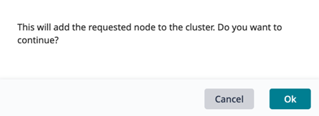

    The Node Addition confirmation dialog displays.
    Add Node Confirmation Dialog
  3. Select OK to begin the Add Node process.
