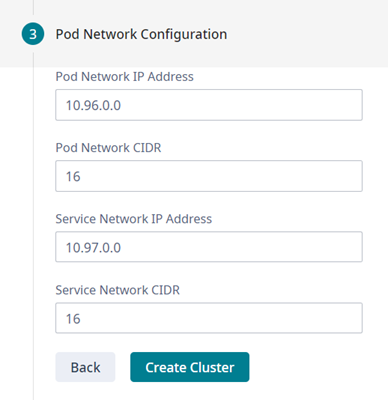

  3. Provide the settings for Pod Network Configuration:
    • Pod Network IP Address (default is 10.96.0.0)
    • Pod Network CIDR (default is 16)
    • Service Network IP Address (default is 10.97.0.0)
    • Service Network CIDR (default is 16)
    Pod Network Default Settings
    Pod Configuration Settings
  4. Select Create Cluster.
  5. Select Done.
