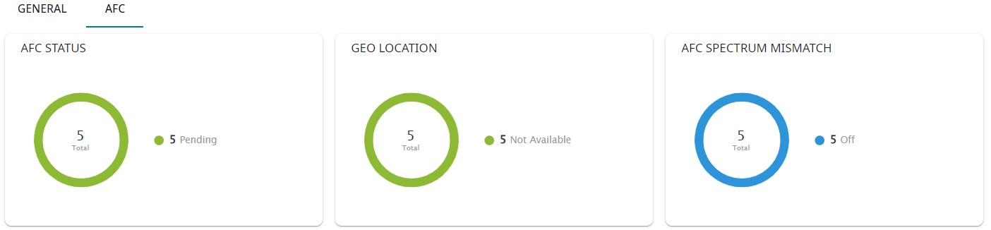

A dashboard summary of the AFC status, Geo Location, and AFC Mismatch info for APs.
AFC Tab
Highlights on the AFC Access Points List:
Status - Indicates service
status.
Name - The AP name.
Model - The AP model (e.g.,
AP5050)
Radio Index - 1, 2, or 3
Geo Location - One of the
following:
Not Available - The initial state after the AP is powered up.
Available - The GPS has locked on sufficient satellites to
determine the coordinates of the AP. The GPS locks within 2 minutes if the AP is exposed to
open sky. If not, the time is unpredictable, depending on signal obstructions.
AFC Status - One of the
following:
PENDING - The
initial state after the AP was powered up, AP waits for “Geo Location Available” and
AFC spectrum response from the AFC server.
AVAILABLE - AFC
spectrum is available until Expire Date shown, 24 hours after the AFC server assigned the
spectrum.
GRACE-PERIOD - The AFC spectrum
needs to be renewed every 24 hours (see AFC Schedule). Ifs the
AFC server is not reachable or not responding at the selected time, the status changes to
GRACE-PERIOD. The
status remains in GRACE-PERIOD until next midnight. If the AFC server stays down, changes to
PENDING and shuts down the radios. When the AFC server recovers the state will change to
PENDING.
NO-SPECTRUM
Expire - Hours to expiration
Power Mode - LPI, SP, or LPI +
SP
Channel - 23e/80 or N/A
Req. Channel - 23e/80
Backup Channel - 7e/80
Power - 12dBm or N/A
Req. Power - 18dBm
Req. Channel and Backup Channel must be the same
channel width.
