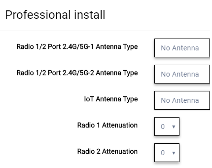

    Professional Install is offered on AP models with external antennas and on AP models that have internal selectable antennas. The AP must be a member of a valid device group.
  3. Select Professional Install.
The fields and corresponding antenna value options on the Professional Install dialog depend on the selected AP and the antenna models that are available. Select an antenna for each available port. For 2x2 transmission (recommended), a pair of antennas must be configured. The lower-numbered connector of the paired antennas must be configured first. By default, for the higher-numbered connector of the pair, the only selectable antenna type is identical to the type selected for the first connector. However, you have the option to select No Antenna for the second antenna connector for 1x1 transmission. Select the antenna model from the drop-down field. Choose the desired attenuation for each radio from the drop-down list. Selectable range is from 0 to 30 dBI. Additionally, the AP3915e, AP3917e, and AP510e access point models offer an external IoT antenna. The AP4020X, AP4020FX, and AP4060X models offer the option to configure an internal or external IOT antenna. The internal IOT antenna is enabled by default, whether an IOT antenna is used or not used.
Single-band antennas limit the AP operation to the radio that is associated with the antenna and reduce the sensor functionality of the IoT sensor radio.
Professional Install Settings (Two port AP)
