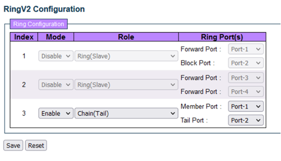

Configuring Chain Tail
Navigate to
Configuration
RingV2
Disable Index1 and Index2, and then enable Index3.
Select role as
Chain(Tail)
Select a member port and a tail port for this chain tail switch.
