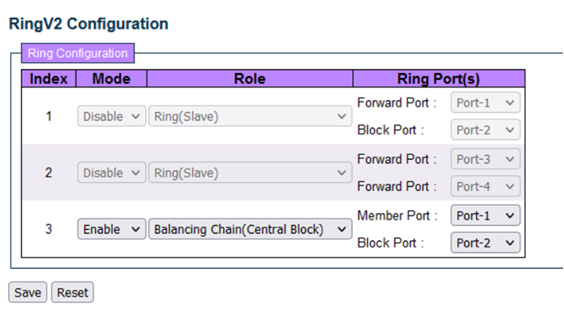

Configuring Balancing Chain – Central Block
Navigate to
Configuration
RingV2
Disable Index1 and Index2, and then enable Index3.
Select role as
Balancing Chain(Central Block)
Select a member port and a block port for this central block switch.
