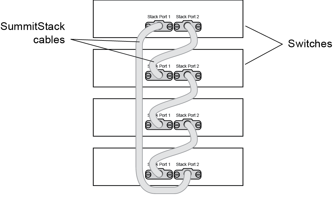

The stack operates as if it were a single switch with a single IP address and a single point of authentication. One switch – called the master switch – is responsible for running network protocols and managing the stack. The master runs ExtremeXOS software and maintains all the software tables for all the switches in the stack.
All switches in the stack, including the master switch, are called nodes. The following figure shows four nodes in a stack, connected to each other by SummitStack cables.
