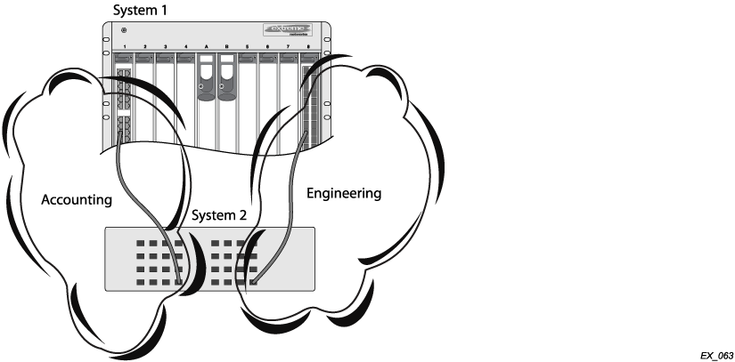

        The following figure illustrates two VLANs
          spanning two switches. On System 2, ports 25 through 29 are part of VLAN Accounting; ports
          21 through 24 and ports 30 through 32 are part of VLAN Engineering. On System 1, all ports
          on slot 1 are part of VLAN Accounting; all ports on slot 8 are part of VLAN
          Engineering.
Two Port-based VLANs Spanning Two Switches
        VLAN Accounting spans System 1 and System 2
          by way of a connection between System 2, port 29 and System 1, slot 1, port 6. VLAN
          Engineering spans System 1 and System 2 by way of a connection between System 2, port 32,
          and System 1, slot 8, port 6.
        Using this configuration, you can create multiple
          port-based VLANs that span multiple switches, in a daisy-chained fashion.
