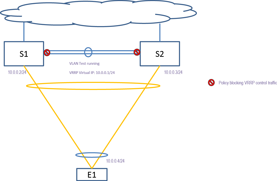

There are two caveats that you need to be aware of that are illustrated in the following figure:
An ARP request from 10.0.0.4 results in duplicate ARP replies (one from each MLAG switch).
For this to work correctly, you have to configure the virtual IP address to be a different address from either of the MLAG peer interface addresses. When an MLAG switch generates an ARP request it uses the vMAC instead of its own switch MAC, and the response (if the reverse path hashing chooses the other MLAG switch) is consumed by the peer MLAG switch.
