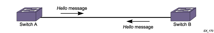

After you enable ELSM on the ports, the peers exchange hello messages with each other as displayed in the following figure.
