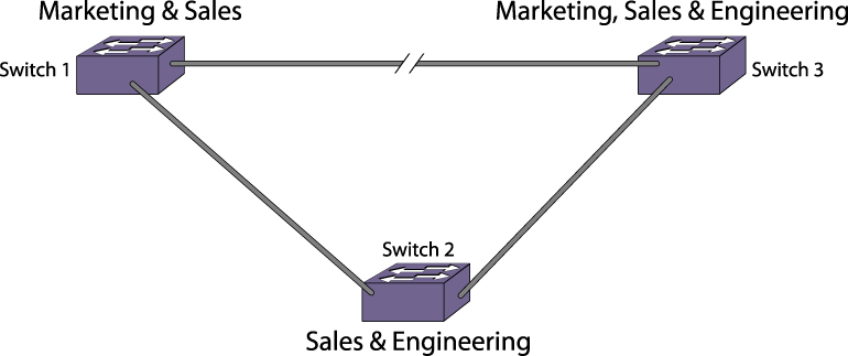

Within a single STPD, you must be extra careful when configuring your VLANs. The following figure illustrates a network that has been incorrectly set up using a single STPD so that the STP configuration disables the ability of the switches to forward VLAN traffic.
The tag-based network in the following figure has the following configuration:
Switch 1 contains VLAN Marketing and VLAN Sales.
Switch 2 contains VLAN Engineering and VLAN Sales.
Switch 3 contains VLAN Marketing, VLAN Engineering, and VLAN Sales.
The tagged trunk connections for three switches form a triangular loop that is not permitted in an STP topology.
All VLANs in each switch are members of the same STPD.
STP can block traffic between switch 1 and switch 3 by disabling the trunk ports for that connection on each switch.
Switch 2 has no ports assigned to VLAN Marketing. Therefore, if the trunk for VLAN Marketing on switches 1 and 3 is blocked, the traffic for VLAN Marketing will not be able to traverse the switches.
If an STPD contains multiple VLANs, all VLANs should be configured on all ports in that domain, except for ports that connect to hosts (edge ports).
