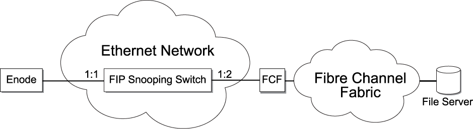

The following figure illustrates an example FIP snooping configuration.
The following commands enable FIP snooping on VLAN “v1” with two ports (1:1 and 1:2) with PFC, jumbo frames, and DCBX enabled.
create vlan "v1" configure vlan v1 tag 20 configure vlan v1 add ports 1:1-2 tagged create qosprofile qp4 configure qosscheduler weighted-round-robin configure qosprofile qp4 weight 1 enable jumbo-frame ports 1:1-2 enable flow-control rx-pause qosprofile qp4 ports 1:1-2 enable flow-control tx-pause priority 3 ports 1:1-2 enable lldp ports 1:1-2 configure lldp ports 1:1-2 advertise vendor-specific dcbx baseline configure lldp ports 1:1-2 dcbx add application name fcoe priority 3 configure lldp ports 1:1-2 dcbx add application name fip priority 3 configure fip snooping add vlan v1 configure fip snooping vlan v1 port 1:1 location perimeter configure fip snooping vlan v1 port 1:2 location fcf-to-enode enable fip snooping vlan v1
