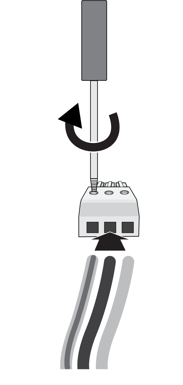

  4. Insert a screwdriver into all three slots on the top of the terminal connector and loosen the screws enough to accommodate a stripped power input cable.
  5. Insert the cable wires into the terminal connector.
    Inserting the cable wires into the DC terminal connector

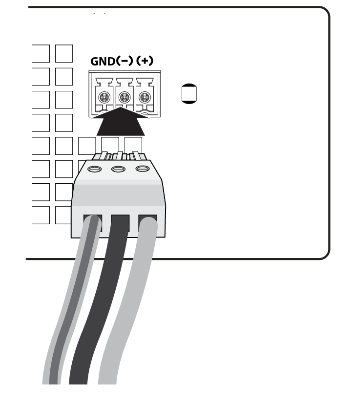

  6. Insert the connector into the slot on the power supply.
    Inserting the DC terminal connector into the slot on the power supply
