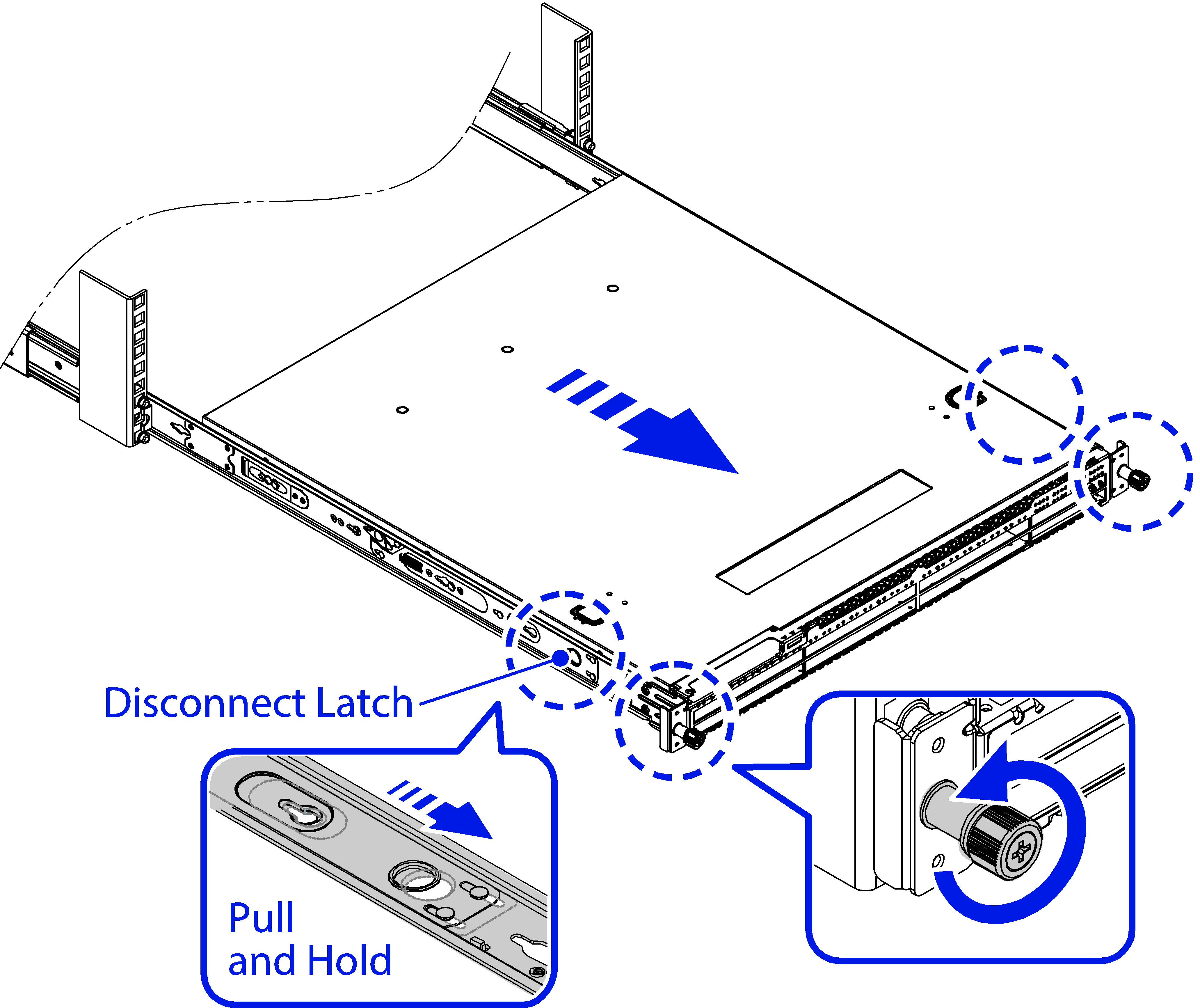

  3. To remove a device from a four-post rack, do the following:
    1. Push the disconnect latch to release the device after it is fully extended.
      Disconnect latch for removal
    2. Disengage the retainers that are connecting the mounting brackets with the sliding rails on both sides.
    3. Carefully slide the device out of the slider assembly and place it on a flat surface.

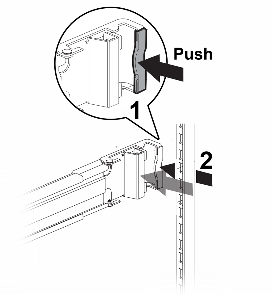

    4. On one of the slider assemblies, push the rear clamp until it separates from the rear rack post.
      See the diagram below
      Removing the Slider Assembly: Rear Rack Post
