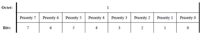

PFC Enable | Size: 1 octet. The PFC Enable bit vector of 8 bits, one per priority. Refer to the above image. A value of one (1) indicates that PFC is enabled for the priority. A value of zero (0) indicates that PFC is disabled for the priority. |
