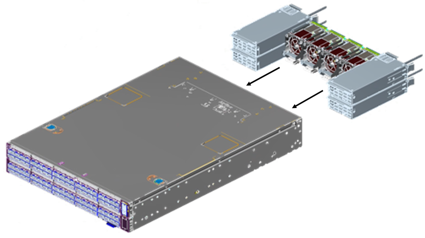

  1. Remove the PSUs and fan modules by removing the two captive retaining screws and sliding all components out of the switch.
    Remove PSUs and fan modules

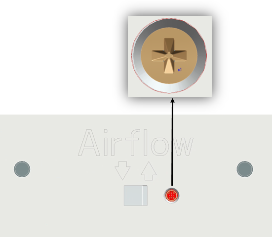

  2. Use a Phillips #1 screwdriver to loosen the chassis screw.
    Chassis switch screw front-to-back airflow

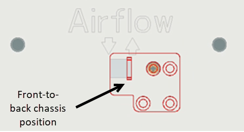

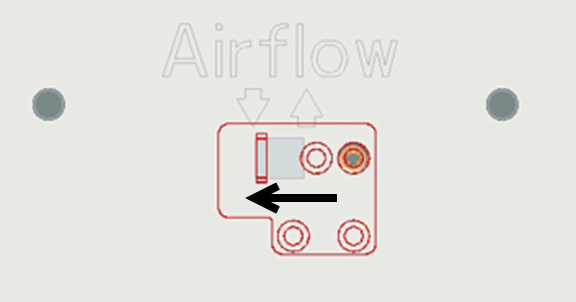

  3. Use a flathead screwdriver to change the chassis switch. The following figure is an example of changing front-to-back airflow to back-to-front airflow.
    Front-to-back airflow chassis position
    Back-to-front airflow chassis position

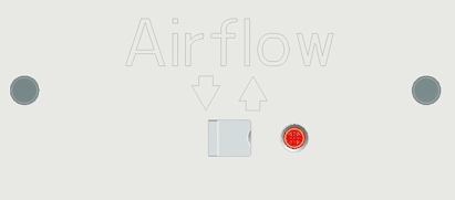

  4. Use a Phillips #1 screwdriver to tighten the chassis screw.
    Chassis screw back-to-front position
  5. Carefully slide the PSUs and fan modules back into the switch.
