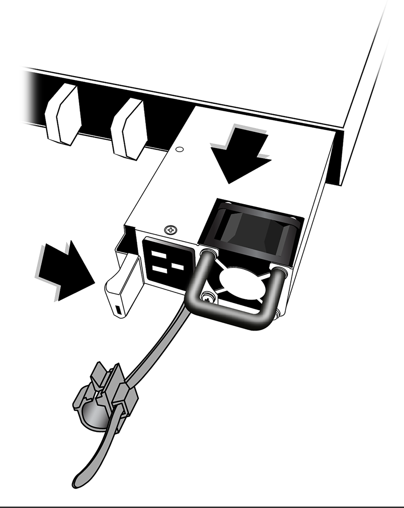

  2. Note the orientation and the airflow direction of the installed power supply, and the location of the latching tab on the power supply.
  3. Push the latching tab toward the power supply handle and pull outward on the handle to disengage the power supply internal connectors.
    Remove a Power Supply
    If you are not installing a replacement power supply, install a cover over the unoccupied power supply bay. Unoccupied bays must always be covered to maintain proper system ventilation and EMI levels.

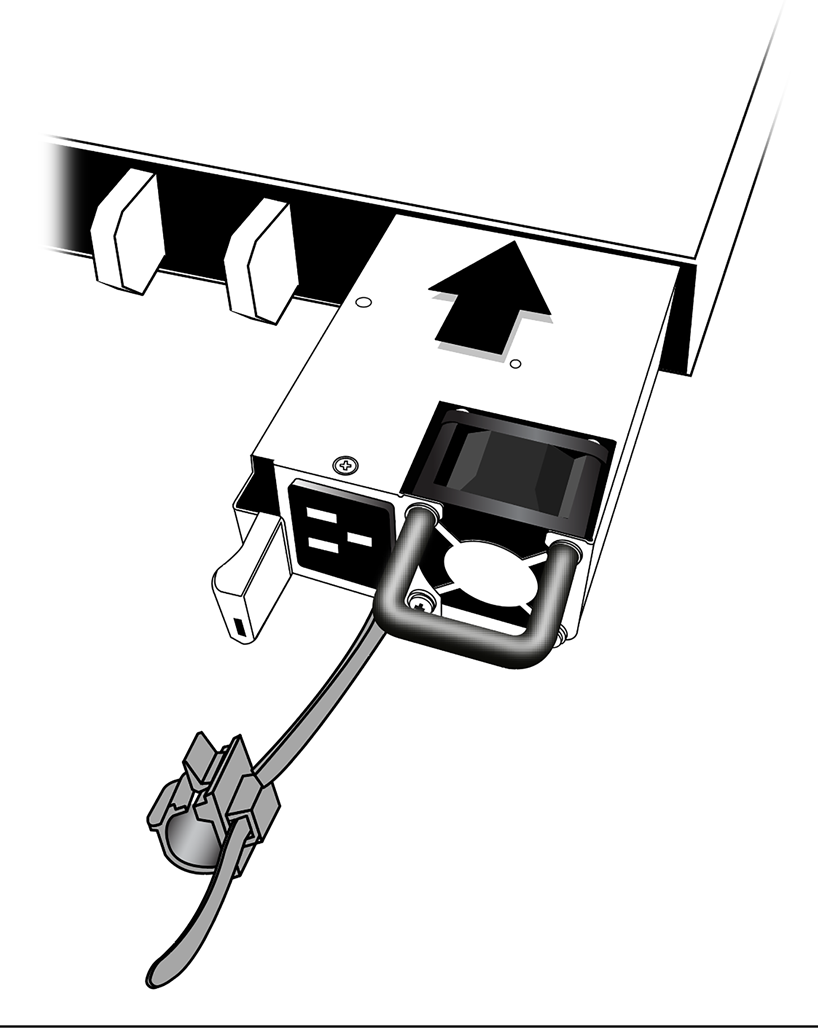

  3. Ensure that the orientation of the power supply is correct, and that the new power supply's airflow direction (front-to-back or back-to-front) is compatible with the installed fan modules and any other installed power supplies.
  4. Carefully slide the power supply all the way into the power supply slot.
    Install a Power Supply
  5. Push the power supply in until the latch snaps into place.
    Do not slam the power supply into the switch.
    Be sure to install a cover over any unoccupied power supply slots. Unoccupied power supply slots must always be covered to maintain proper system ventilation and EMI levels.
To install or replace a second power supply repeat this procedure.

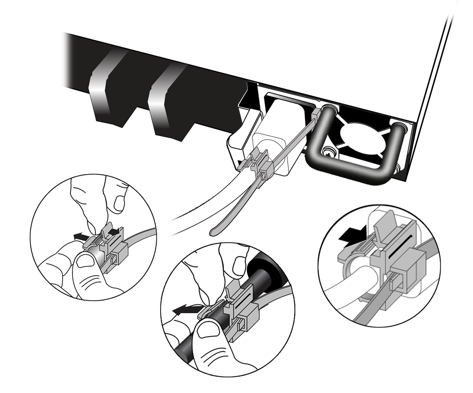

Connect an AC Power Supply to an AC Power Outlet Using the Retainer
  1. Connect the AC power cord.
    1. If necessary, slide the plastic cord retainer farther away from the back of the switch.
    2. Connect the AC power cord to the input connector.
    3. Open the clip and slip it over the barrel of the connector.
      The diagram below - Power Supply with Power Cord and Retainer Attached shows the power supply with the power cord and retainer in place.
    4. Snap the clip firmly around the connector.
