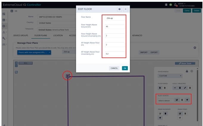

The Edit Floor Plan window with the following fields: Floor plan name; Floor height above ground level in meters; Floor height above ground level, uncertainty in meters; AP height above floor level in meters; AP height above floor level, uncertainty in meters;Floor plan Boundary
Automatic Frequency Coordination (AFC) deployments require a floor plan for each floor in the deployment. Configure the following settings for each plan:
You can edit an existing floor plan. You do not need a new floor plan for an AFC deployment.
