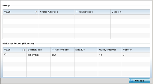

IGMP is a protocol used for managing members of IP multicast groups. An access point listens to IGMP network traffic and forwards IGMP multicast packets to radios on which interested hosts are connected. On the wired side of the network, the access point floods all the wired interfaces. IGMP reduces unnecessary multicast traffic floods within the network and help reduce administrative overhead.
To view a AP-managed network's IGMP configuration:
| VLAN | Displays the group VLAN where the multicast transmission is conducted. |
| Group Address | Displays the Multicast Group ID supporting the statistics displayed. This group ID is the multicast address hosts are listening to. |
| Port Members | Displays the ports on which multicast clients have been discovered. For example, ge1, radio1, etc. Ports can vary somewhat amongst supported controller and service platform models. |
| Version | Displays each listed group IGMP version compatibility as either version 1, 2 or 3. |
| Learn Mode | Displays the learning mode used by the router as either Static or PIM-DVMRP. |
| Port Members | Displays the physical ports on which multicast clients have been discovered by the multicast router. For example, ge1, radio1, etc. Ports can vary somewhat amongst supported controller and service platform models. |
| MiNT IDs | Lists MiNT IDs for each listed VLAN. MiNT provides the means to secure access point profile communications at the transport layer. Using MiNT, an access point can be configured to only communicate with other authorized (MiNT enabled) access points of the same model. |
| Query Interval | Lists the IGMP query interval implemented when the querier functionality is enabled. The default value is 60 seconds. |
| Version | Lists the multicast router IGMP version compatibility as either version 1, 2 or 3. The default setting is 3. |
