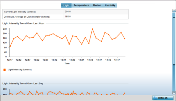

            - Refer to the
                  Light table to assess the sensor's detected light intensity within the
                  AP 8132 immediate deployment area.
Light
                  intensity is measured by the sensor in lumens. The table displays the Current Light Intensity (lumens)
                  and the  20 Minute
                     Average of Light Intensity (lumens). Compare these two items to
                  determine whether the AP 8132‘s deployment location remains consistently lit, as an
                  administrator can power off the access point‘s radios when no activity is detected
                  in the immediate deployment area.
            - Refer to the Light Intensity Trend Over Last
                  Hour graph to assess the fluctuation in lighting over the last hour.
               Use this graph to assess the deployment areas light intensity of particular hours of
               the day as needed to conjunction with the daily graph immediately below it.
            - Refer to the Light Intensity Trend Over Last Day graph to assess whether lighting
               is consistent across specific hours of the day. Use this information to help
               determine whether the AP 8132 can
               be upgraded or powered off during specific hours of the day.
