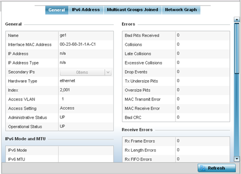

The General screen provides information on a selected access point interface such as its MAC address, type and TX/RX statistics.
To view the general interface statistics:
The General field describes the following:
