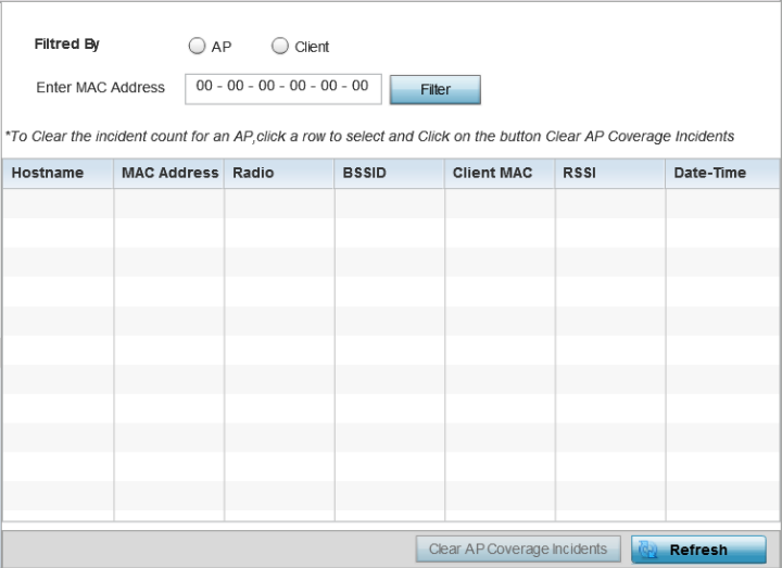

In addition to the RF Domain‘s Coverage Hole Summary, a specific access point‘s coverage hole history can be reviewed in detail. Consider using different RF Domain member access points or their connected clients to help validate the data reported before compensating for the coverage hole by increasing the radio transmit power of neighboring access points.
To view a RF Domain‘s member access point's coverage hole details:
| Hostname | Lists the administrator assigned hostname used as each listed access point‘s network identifier. This is the access point whose client(s) are reporting coverage hole RSSI data. |
| MAC address | Lists the reporting access point's MAC address. |
| Radio | Lists the access point radio receiving and reporting coverage hole RSSI data from the listed client MAC. |
| BSSID | Displays the BSSID (basic service set identifier) included in an access point‘s wireless packet transmissions. Packets need to go to their correct destination. While a SSID keeps packets within the correct WLAN there is usually multiple access points within each WLAN. A BSSID identifies the correct access point and its connected clients. |
| Client MAC | Lists each connected client‘s hardware encoded MAC address. This is the client reporting coverage hole RSSI data to its connected access point radio. |
| RSSI | Displays the RSSI (Received Signal Strength Indicator) of the detecting Access Radio or client. |
| Date-Time | Displays the date and time when each listed access point received its coverage hole indecent information. |
