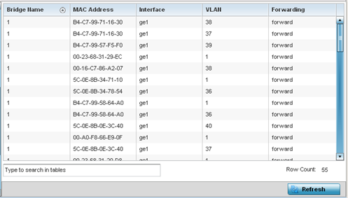

To view an access point's Bridge statistics:
| Bridge Name | Displays the numeric ID of the network bridge. |
| MAC Address | Displays the MAC address (factory encoded hardware identifier) of the bridge. |
| Interface | Displays the interface (access point physical port name) where the bridge transferred packets. Supported access points models have different port configurations. |
| VLAN | Displays the VLAN the bridge is using as a virtual interface within the network. |
| Forwarding | Displays whether the bridge is forwarding packets and is in a forwarding state. A bridge can only forward packets. |
