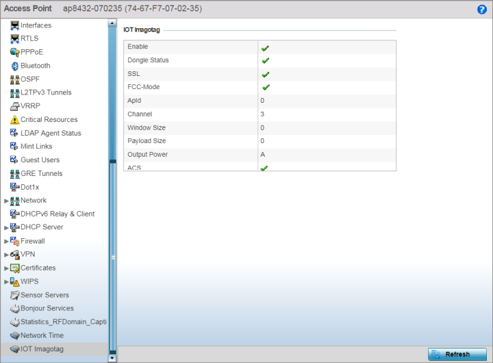

To view an AP-8432 model access point‘s ESL communicator configuration:
  1. Select the Statistics menu from the Web UI.
  2. Select System from the navigation pane (on the left-hand side of the screen). Expand an RF Domain, select a controller or service platform, and select one of its connected AP-8432 access point.
  3. Select IOT Imagotag from the AP‘s statistics menu.
    Statistics → Access Point → IOT Imagotag screen
  4. Review the following IOT Imagotag details:
    Enable Displays the status of the policy: Enabled/Disabled. A green check mark indicates that the policy is enabled. A red cross mark indicates that the policy is disabled.
    Dongle Status Displays the ESL communicator (USB Dongle) status - Connected/Disconnected.
    SSL Displays if SSL (Secure Socket Layer) encryption mode of communication is enabled or not. A green check mark indicates that this option is enabled. A red cross mark indicates that this option is disabled.
    FCC-Mode Displays if FCC compatibility mode is enabled or not on the ESL communicator. A green check mark indicates that this option is enabled. A red cross mark indicates that this option is disabled.
    ApId Displays the Imagotag enabled AP‘s ID.
    Channel Displays the channel assigned for ESL communicator to tag communication in the 2.4 GHz band.
    Window Size Displays the transmission window size set for messages exchanged between ESL communicator and tags.
    Payload Size Displays the maximum payload size in packets exchanged between ESL communicator and tags.
    Output Power Displays the maximum output power set for the ESL communicator.
    ACS Displays if ACS (Auto-Channel Selection) status - Enabled/Disabled.
