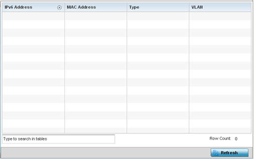

To view an access point‘s IPv6 neighbor statistics:
| IPv6 Address | Lists an IPv6 IP address for neighbor discovery. IPv6 hosts can configure themselves automatically when connected to an IPv6 network using the neighbor discovery protocol via CMPv6 router discovery messages. When first connected to a network, a host sends a link-local router solicitation multicast request for its configuration parameters; routers respond to such a request with a router advertisement packet that contains Internet Layer configuration parameters. IPv6 addresses are composed of eight groups of four hexadecimal digits separated by colons. |
| MAC Address | Lists the factory encoded hardware MAC address of the neighbor device using an IPv6 formatted IP address as its network identifier. |
| Type | Displays the device type for the neighbor solicitation. Neighbor solicitations request the link layer address of a target node while providing the sender‘s own link layer address to the target. Neighbor solicitations are multicast when the node needs to resolve an address and unicast when the node seeks to verify the reachability of a neighbor. Options include Host, Router and DHCP Server. |
| VLAN | Lists the virtual interface (from 1 - 4094) used for the required neighbor advertisements and solicitation messages used for neighbor discovery. |
