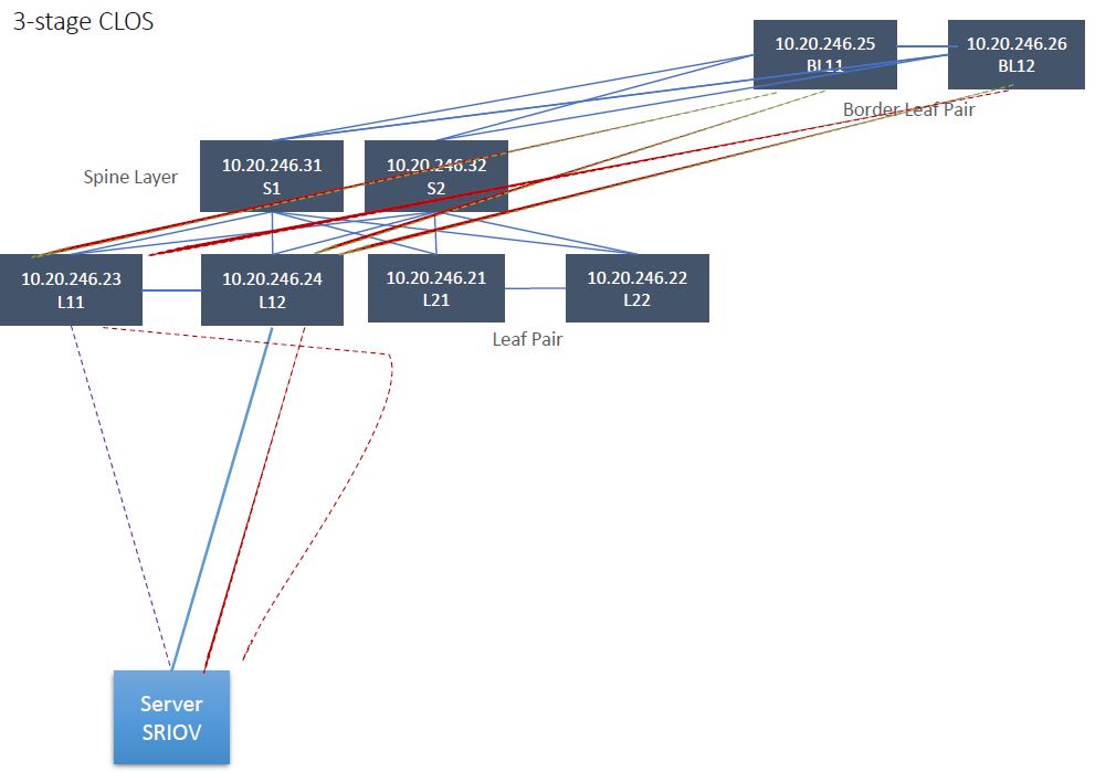

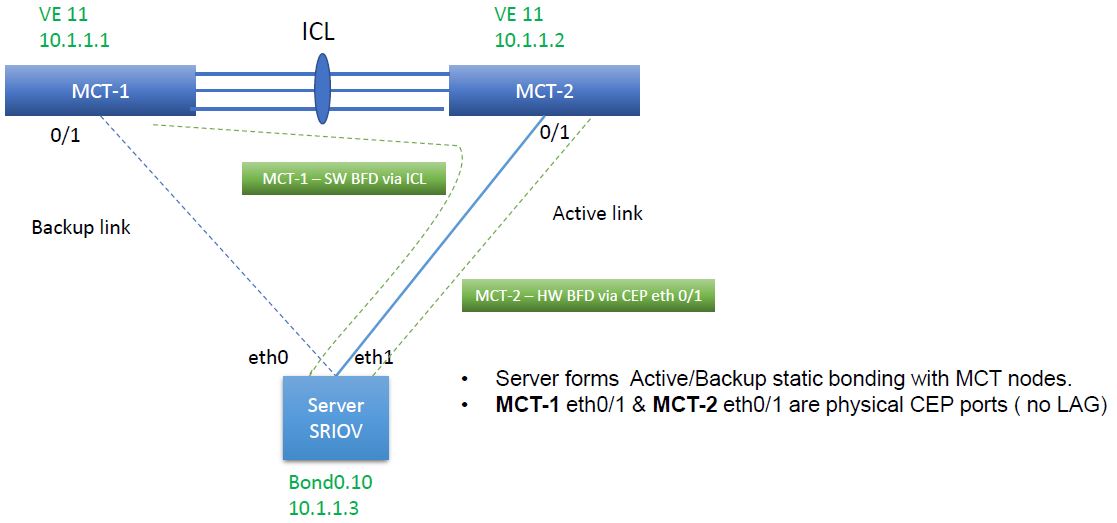

Transition between software and hardware based BFD is not supported. Therefore, during session formation with SRIOV, BFD does not come up during link failover.
                                        interface Ethernet 0/1 cluster-track bfd-software-session switchport switchport mode trunk switchport trunk allowed vlan add 11 no switchport trunk tag native vlan no shutdown !  |
                                        interface Port-channel 1 cluster-track bfd-software-session switchport switchport mode trunk switchport trunk allowed vlan add 11 no switchport trunk tag native vlan no shutdown !  |
EFA automates the cep-bfd-session-type on the CEP interfaces based on the logic, with no additional input from the users.

The cep-bfd-session-type feature enables you to provide cep bfd session type per EPG which gets configured on all the ethernet and single homed port channel interfaces defined in the EPG.
The default value of cep bfd session type is set to “auto”. EFA automatically derives the appropriate cep bfd session type based on the use case (extension or l3 hand off) and endpoint type.
