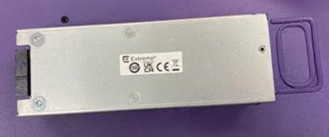

5720-VIMs are ordered separately. Each VIM label can be found on the bottom side of the device, as seen in the following figure:
5720-VIM Label
5720-VIM Label
