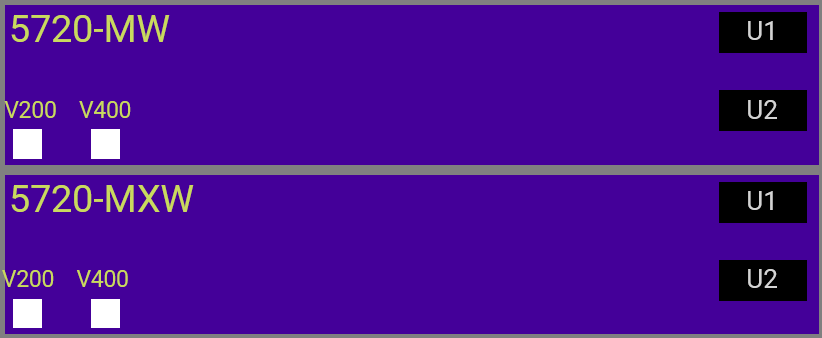

  2. Find a switch model in the Switches column.
    Each switch model is represented by a rectangle, as shown in the example in the following figure.ach switch model is represented by a rectangle, as shown in the example in the following figure. In this example, stacking ports are represented by U1 and U2 on the right side.
    5720 Switch Shown in the Stacking Tool
    5720 Switches Shown in the Stacking Tool
    Tip
    Tip
    Select a rectangle to display more information about the switch model and the VIMs (if any) that it can use for stacking.
