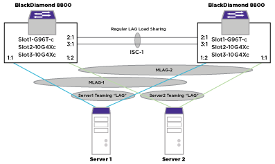

Below is an example of how to configure an MLAG. Simple MLAG Configuration shows a finished MLAG network.
Description: The ISC provides an out-of-band IP communications path between the two MLAG peer switches to exchange keep-alive packets and to checkpoint various state information between switches.

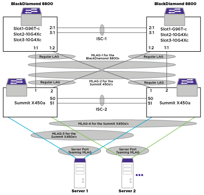

Simple MLAG Configuration, shows a basic MLAG network. Two-tier MLAG Network shows a network with back-to-back aggregation. There is one MLAG configured on the BlackDiamond switches and three configured on the ExtremeSwitching switches.
