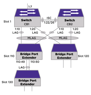

The following example shows how to use full automation, partial automation, or manual configuration to set up a redundant controlling bridge (CB) topology with three attached bridge port extenders (BPEs) in a two-tier structure (see Redundant CBs with Two-Tier BPEs Topology).
enable sharing 1:22 group 1:22,1:26 lacp create vlan isc tag 100 configure isc ipaddress 1.1.1.1/24 configure isc add port 1:22 tagged create mlag peer vpex_peer configure mlag peer vpex_peer ipaddress 1.1.1.2
enable sharing 1:22 group 1:22,1:26 lacp create vlan isc tag 100 configure isc ipaddress 1.1.1.2/24 configure isc add port 1:22 tagged create mlag peer vpex_peer configure mlag peer vpex_peer ipaddress 1.1.1.1
