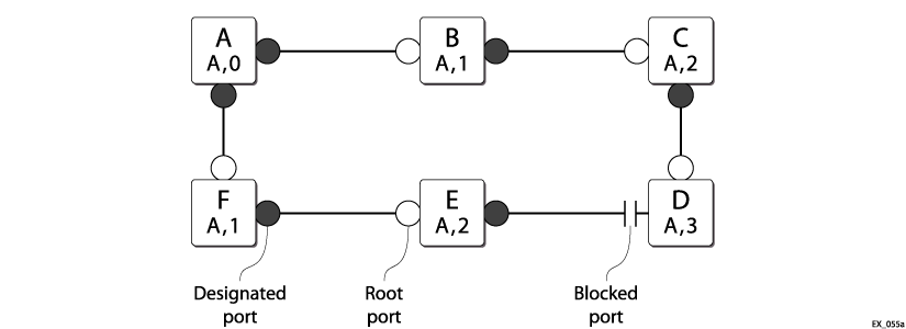

Suppose you have a network, as shown in Initial Network Configuration, with six bridges (bridge A through bridge F) where the following is true:
Bridge A is the root bridge.
Bridge D contains an alternate port in the blocking state.
All other ports in the network are in the forwarding state.

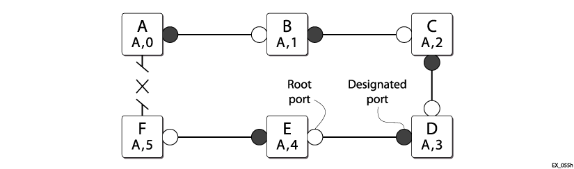

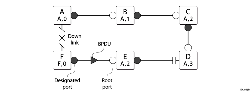

If the link between bridge A and bridge F goes down, bridge F detects the root port is down. At this point, bridge F:
Immediately disables that port from the STP.
Performs a configuration update.

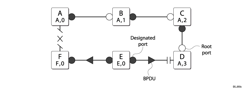

As shown in Down Link Detected, after the configuration update, bridge F:
Considers itself the new root bridge.
Sends a BPDU message on its designated port to bridge E.
Determines that it received an inferior BPDU.
Immediately begins the max age timer on its root port.

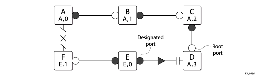

As shown in New Root Bridge Selected, after the configuration update, bridge E:
Regards itself as the new root bridge.
Sends BPDU messages on both of its designated ports to bridges F and D, respectively.
Decides that the receiving port is the root port.
Determines that bridge E is the root bridge.
Immediately begins the max age timer on its alternate port.

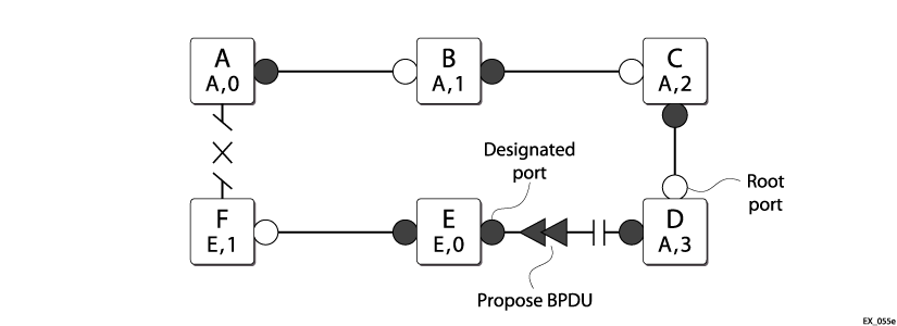

As shown in Sending a Propose Message to Confirm a Port Role, after the configuration update, bridge D:
Moves the alternate port to a designated port.
Sends a “propose” message to bridge E to solicit confirmation of its designated role and to rapidly move the port into the designated state.
Changes its receiving port to a root port.
The existing designated port enters the blocking state.

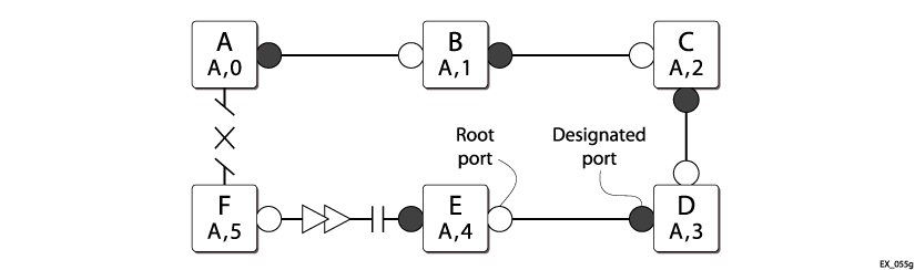

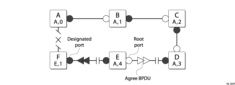

Bridge E then sends:
A “propose” message to bridge F.
An “agree” message from its root port to bridge D.
Bridge D moves the port that received the “agree” message into the forwarding state.
Bridge F confirms that its receiving port (the port that received the “propose” message) is the root port, and immediately replies with an “agree” message to bridge E to unblock the proposing port.
