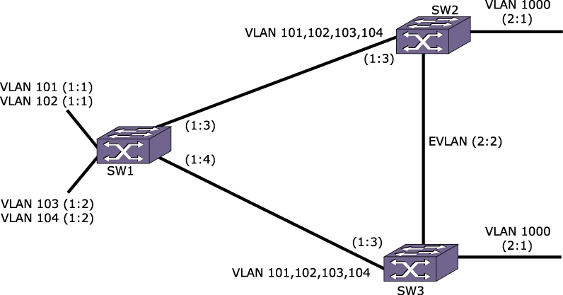

The example in ESRP Redundancy Configuration Example configures a VLAN translation network with ESRP redundancy.
The SW2 and SW3 VLAN translation switches are protected by an ESRP control VLAN. The master ESRP switch performs the translation and provides the connectivity to the backbone. If a failure occurs, the slave ESRP switch takes over and begins performing the translation.
