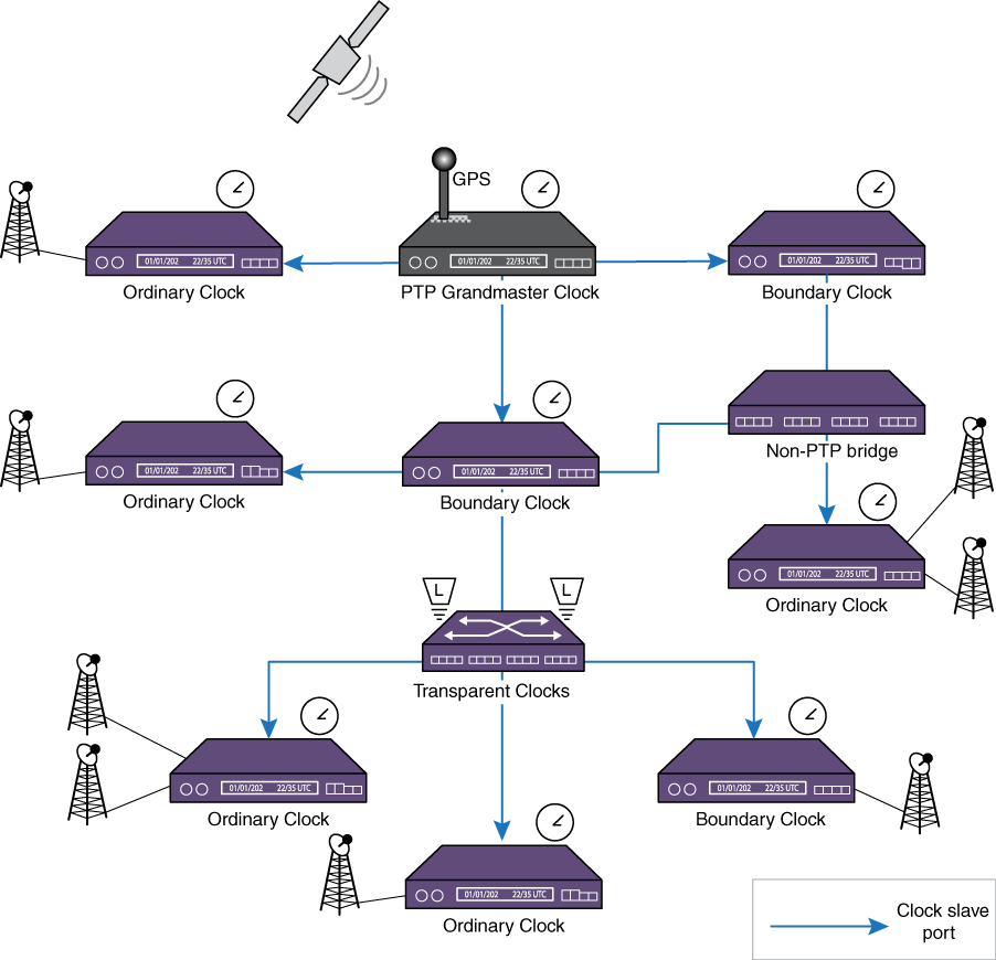

A PTP network must have a grandmaster clock reference and a slave. Between a master and a slave, a PTP network may have multiple boundary clocks, transparent clocks, and non-PTP bridges.
PTP Network Hierarchy illustrates a typical PTP network hierarchy.
