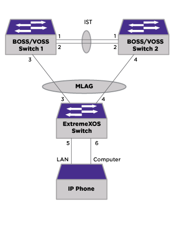

Simple Loop Prevention Protocol (SLPP) is an application that detects loops in an This command is available on all Universal switches supported in this document. or Split Multi-link Trunking (SMLT) network on VOSS/BOSS switches.
When SLPP Guard disables a port, the disabled status is not persistent. If the switch reboots, the port is enabled when the switch comes back up.
If you use the CLI to enable or disable a port that has been disabled by SLPP Guard, the port is enabled or disabled as applicable and the recovery timer is stopped for that port.When a new user is authenticated by netlogin, the enable attribute of SLPP Guard is given to netlogin. Netlogin processes this attribute and sends the enable attribute message to the SLPP Guard module. If all users are unauthenticated by netlogin, a disable message for the port is sent to SLPP Guard. At the time of re-authentication, if the FA-Service-Request = SLPPGUARD is removed from the RADIUS server, then netlogin sends an SLPP Guard disable message.
If you modify the RADIUS attributes in between authentication, then a port restart or clear all netlogin clients is required in order for the service attributes to change on the port.The status is enabled and the entry in the save configuration command is sent to enable slpp guard port port_list for the following scenarios:
The status is enabled and the saved configuration contains default values for the following scenarios:
