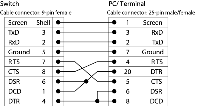

Null-Modem Cable Pinouts shows the pinouts for a 9-pin to 25-pin (RS-232) null-modem cable.

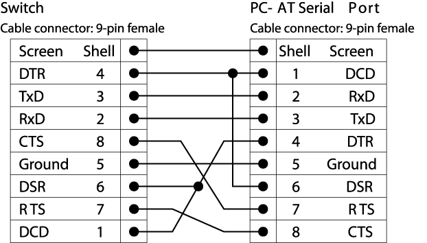

PC-AT Serial Null-modem Cable Pinouts shows the pinouts for a 9-pin to 9-pin (PC-AT) null-modem serial cable.
