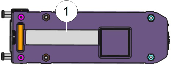

VIM5s are ordered separately. Each VIM5 label can be found on the bottom side of the device, as seen in the following figure:
1 = VIM5 label |
