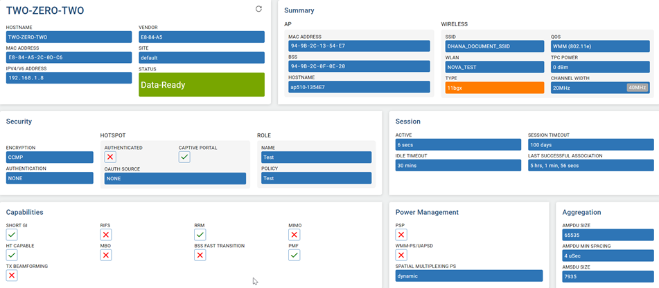

Client Connectivity
Example of Client Connectivity Information Display shows an example of a client connectivity information display.
Client connectivity information is arranged under the following panes (left-to-right, top-to-bottom):

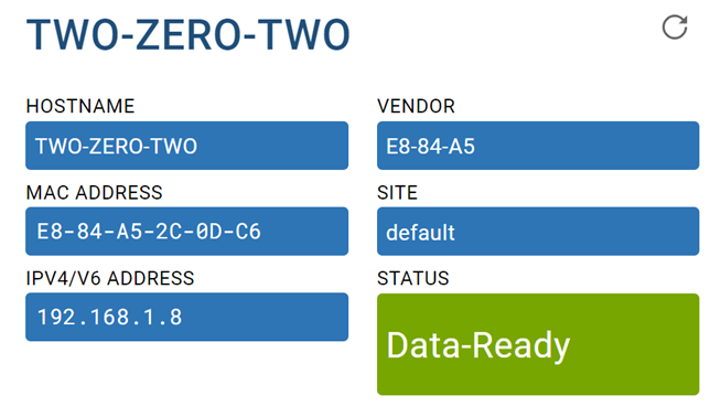

Client Information
Client Connectivity – Example of Client Information Display shows an example of client information collected and displayed.
Select to refresh the display.
Client Connectivity – Client Information Description describes the information displayed.
Table 1. Client Connectivity – Client Information Description
FieldDescription
HostnameDisplays the hostname of the selected wireless client.
VendorDisplays the vendor name (manufacturer) of the wireless client.
MAC AddressDisplays the factory encoded MAC address of the selected wireless client.
SiteDisplays the site (RF Domain) at which the client has a connection.
IPv4/IPv6 AddressDisplays the IPv4 or IPv6 address the selected wireless client is currently utilizing as a network identifier.
Status
Displays the current operational status of the wireless client. The possible client status values include:
  • Data Ready
  • Not Data Ready
  • Roaming
  • Not Roaming

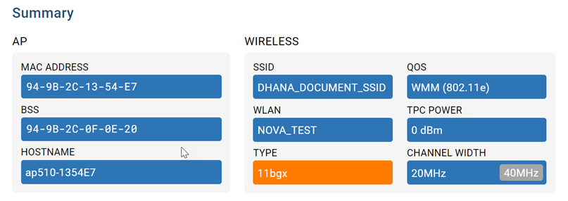

Summary
Client Connectivity – Example Summary Display shows an example of information displayed for a client-connected access point (AP) and the Wireless LAN (WLAN) with which it is associated.
Client Connectivity – Summary Display Description describes the information displayed.
Table 2. Client Connectivity – Summary Display Description
FieldDescription
AP
MAC AddressDisplays the MAC address of the wireless client's connected AP.
BSSDisplays the MAC address of the Basic Service Set (BSS) to which the AP belongs. A BSS is a set of stations that can communicate with one another.
HostnameDisplays administrator-assigned hostname of the AP reporting client stats to RF Domain member devices.
Wireless
SSIDDisplays the SSID assigned to the WLAN.
QoSIdentifies the WLAN QoS policy setting.
WLANDisplays the name assigned to the WLAN when it was created.
TPC PowerDisplays the transmit power control (TPC) mitigation value (in dBm), if it is configured. Transmit power is configured for radio interface. A value of 0 (zero) in this field indicates that Smart RF manages the power.
Type
Displays the radio type. The possible radio type values include:
  • 802.11b
  • 802.11bg
  • 802.11bgn
  • 802.11a
  • 802.11an
Channel WidthDisplays the current channel width versus the maximum possible channel width (shaded in gray).

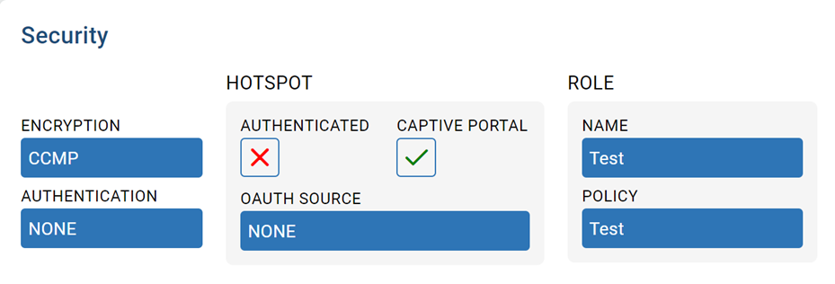

Security
Client Connectivity – Example of Security Display shows an example display of Security information for the selected wireless client.
Client Connectivity – Security Display Description describes the information displayed.
Table 3. Client Connectivity – Security Display Description
FieldDescription
Encryption
Identifies the encryption scheme, as defined in WLAN Security settings.
Authentication
Identifies the authentication scheme, as defined in WLAN Security settings.
Hotspot
AuthenticatedIndicates whether the client successfully authenticated by guest access
Captive PortalIndicates whether a Captive Portals policy is enforced on the WLAN connected to an AP that is deployed as a public hotspot.
Oauth SourceIdentifies the source of how the user is oauthed using social media login. Possible sources include Facebook, Google, Twitter, Linkedin, or None.
Role
NameDisplays the assigned user Role Name in a Role policy that is applied to the AP.
PolicyDisplays the name of the Role policy that is applied to the AP.

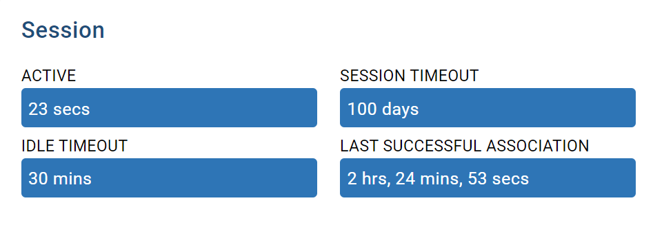

Session
Client Connectivity – Example Session Display shows an example display of Session information for the selected wireless client.
Client Connectivity – Session Display Description describes the information displayed.
Table 4. Client Connectivity – Session Display Description
FieldDescription
ActiveDisplays the duration (in seconds) of the last active session between the wireless client and its connected AP.
Session TimeoutDisplays the duration for which a session can be maintained by the wireless client without it being disassociated from its connected AP radio.
Idle TimeoutDisplays the Inactivity Timeout setting of the Captive Portal policy applied to the AP.
Last Successful AssociationDisplays the duration the wireless client was in association with its connected AP.

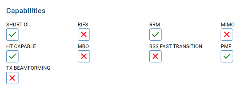

Capabilities
Client Connectivity – Example Capabilities Display shows an example Capabilities display for the selected client.
Client Connectivity – Capabilities Display Description describes the information displayed.
Table 5. Client Connectivity – Capabilities Display Description
FieldDescription
Short GIIndicates whether Short Guard Interval is enabled for the radio.
RIFSIndicates whether RIFS (Reduced Interframe Spacing) parameters are configured for the radio.
RRMIndicates whether RRM (Radio Resource Management) settings are configured for the WLAN.
MIMOIndicates whether MU-MIMO (multi-user multiple input multiple output) is configured for the radio. MU-MIMO is disabled by default.
HT Capable
Indicates whether clients with higher throughput (802.11n clients) are prioritized over clients with slower throughput (802.11 a/ b/g) clients.
Prefer HT Clients is disabled by default under Advanced settings for the radio.
MBOIndicates whether Multi Band Operation is enabled or disabled (default) for the WLAN.
BSS Fast TransitionIndicates whether Fast BSS Transition is enabled or disabled (default) for the WLAN.
PMFIndicates whether Protected-management-frames (PMF) enforcement is enabled for the WLAN.
TX BeamformingIndicates whether transmit beamforming is enabled for the radio.
Note: This feature is enabled on the radio interface using CLI command transmit-beamforming.

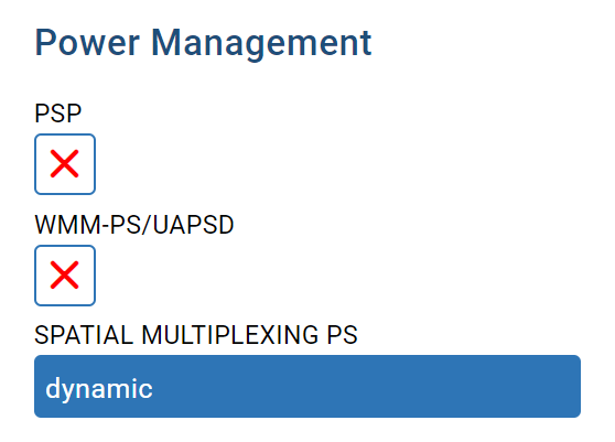

Power Management
Client Connectivity – Example Power Management Display shows an example Power Management display for the selected client.
Client Connectivity – Power Management Display Description describes the information displayed.
Table 6. Client Connectivity – Power Management Display Description
FieldDescription
PSP
Indicates whether PSP (Power Save Poll ) mode is enabled or disabled.
  • means PSP is enabled.
  • means PSP is disabled.
Power Save Poll is a protocol that helps to reduce the amount of time a radio needs to be powered. PSP allows the WiFi adapter to notify the AP when the radio is powered down. The AP holds any network packet to be sent to this radio.
WMM-PS/UAPSDIndicates whether WMM-PS (WMM Power Save)/U-APSD (Unscheduled Automatic Power Save Delivery) is enabled or disabled. The WMM Power Save mechanism (enabled by default) is applied through a Radio QoS policy. See Radio QoS Policies for details.
Spatial Multiplexing PSDisplays whether this feature is enabled on the wireless client. The SM (spatial multiplexing) power save mode allows an 802.11n client to power down all but one of its radios. This power save mode has two sub modes of operation: static operation and dynamic operation.

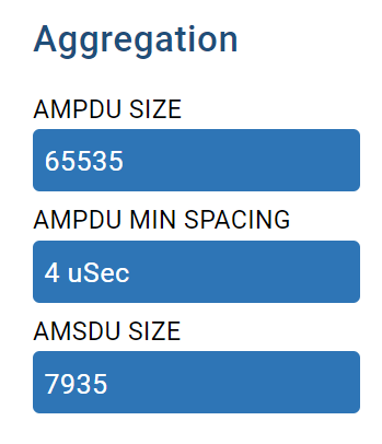

Aggregation
Client Connectivity – Aggregation shows an example of an Aggregation display.
Client Connectivity – Aggregation Display Description describes the information displayed.
Table 7. Client Connectivity – Aggregation Display Description
FieldDescription
AMPDU SizeDisplays the maximum size of AMPDU (in bytes). AMPDU is a set of Ethernet frames addressed to the same destination wrapped in an 802.11n MAC header. AMPDUs are used in noisy environments to provide reliable packet transmission.
AMPDU Min SpacingDisplays the time interval between two consecutive Ethernet frames (in uSec).
AMSDU SizeDisplays the maximum size of AMSDU frame size (in bytes). AMSDU is a set of Ethernet frames addressed to the same destination that are wrapped in a 802.11n frame.
