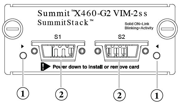

The VIM-2ss module permits stacking using the standard SummitStack cables. With this module it is possible to stack with X460 and X480 switches.
VIM-2ss SummitStack Module
../Graphics/x460-g2_vim2ss.png
1 = LEDs 2= Stacking ports

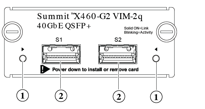

The VIM-2q module connects to QSFP+ cables to form stacks using the SummitStack-V160 protocol. This module is not compatible with the SummitStack-V80 module that is used on the X460 and X480 switches.
VIM-2q Port Option Card
../Graphics/x460-g2_vim2q.png
1 = LEDs 2= QSFP+ ports
VIMs are not hot swappable. You must power down the switch before installing any VIMs.
