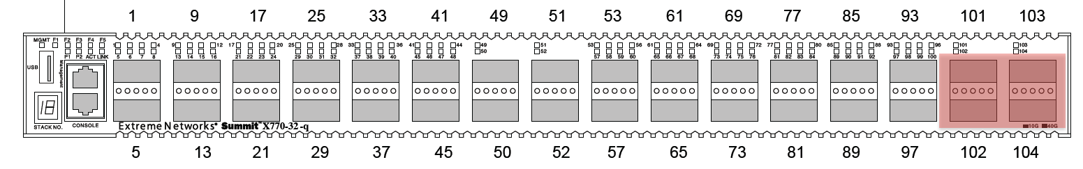

Native Stacking for X770 Switches
For X770 native stacking, use the fixed 40G QSFP+ ports numbered 101, 102, 103, and 104 (shown in Location of Stacking Ports (101 through 104) on an X770 Switch). The X770 supports SummitStack-V80, V160, and V320 stacking. Use any Extreme Networks certified 40G QSFP+ cable or optical transceiver to make the connections among the switches to be stacked.
For a complete listing of compatible cables and optical transceivers, see the Extreme Hardware/Software Compatibility and Recommendation Matrices.

Switch Model Type or location of Native Stacking Ports Alternate Stacking Ports Location of Alternate Stacking Ports
X770-32q Ports 101,102,103,104 103,104 Front panel
Ports 103 and 104 are not available as data ports when the alternate stacking ports are used. Ports 101 and 102 remain available to use as data ports.
