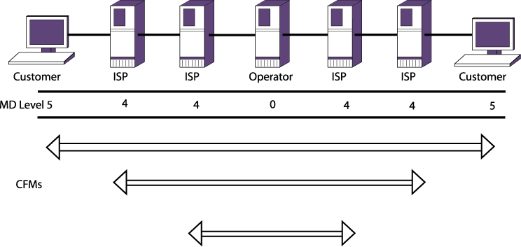

The following figure shows an example of hierarchical CFM domains.
CFM Hierarchical Domains Example
The arrows in the above figure indicate the span that CCM messages take, not the direction. (See CFM UP and DOWN MEP at the Logical Level for more information on spans for CCM messages.) This has been removed until the missing xref can be fixed.

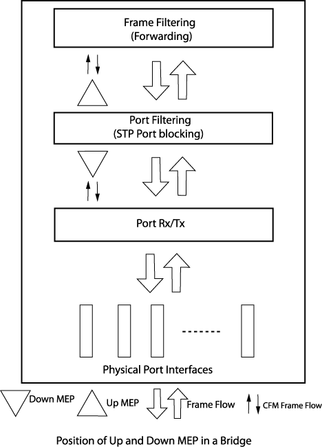

The following figure shows the concept of UP and DOWN MEP at logical level:
You must have at least one MP on an intermediate switch in your domain. Ensure that you map and configure all ports in your domain carefully, especially the UP MEPs and the DOWN MEPs. If these are incorrectly configured, the CCMs are sent in the wrong direction in your network, and you will not be able to test the connectivity within the domain.
