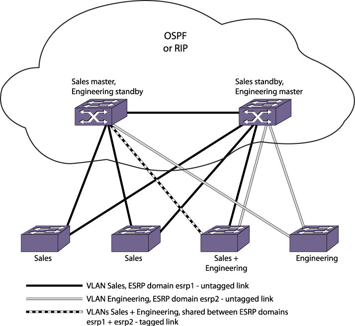

Multiple Domains Using Layer 2 and Layer 3 Redundancy
The example shown in the following figure illustrates an ESRP configuration that has multiple domains using Layer 2 and Layer 3 redundancy.
Multiple ESRP Domains Using Layer 2 and Layer 3 Redundancy
This example builds on the previous example. It has the following features:
  • An additional VLAN, Engineering, is added that uses Layer 2 redundancy.
  • VLAN Sales uses three active links to each ESRP switch.
  • VLAN Engineering has two active links to each ESRP switch.
  • One of the edge devices carries traffic for both VLANs.
  • The link between the third edge device and the first ESRP switch uses 802.1Q tagging to carry traffic from both VLANs on one link. The ESRP switch counts the link active for each VLAN.
  • The second ESRP switch has a separate physical port for each VLAN connected to the third edge switch.
In this example, the ESRP switches are configured such that VLAN Sales normally uses the first ESRP switch and VLAN Engineering normally uses the second ESRP switch. This is accomplished by manipulating the ESRP priority setting for each VLAN for the particular ESRP switch.
