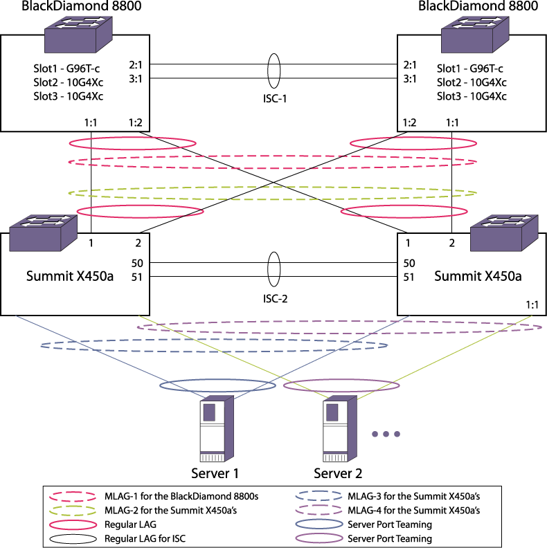

Example of MLAG Configuration
Below is an example of how to configure an MLAG. The following figure shows a finished MLAG network.
Simple MLAG Configuration

    The previous figure, the example above, shows a basic MLAG network. The following figure shows a network with back-to-back aggregation. There is one MLAG configured on the BlackDiamond switches and three configured on the Summit switches.
    Two-tier MLAG Network
